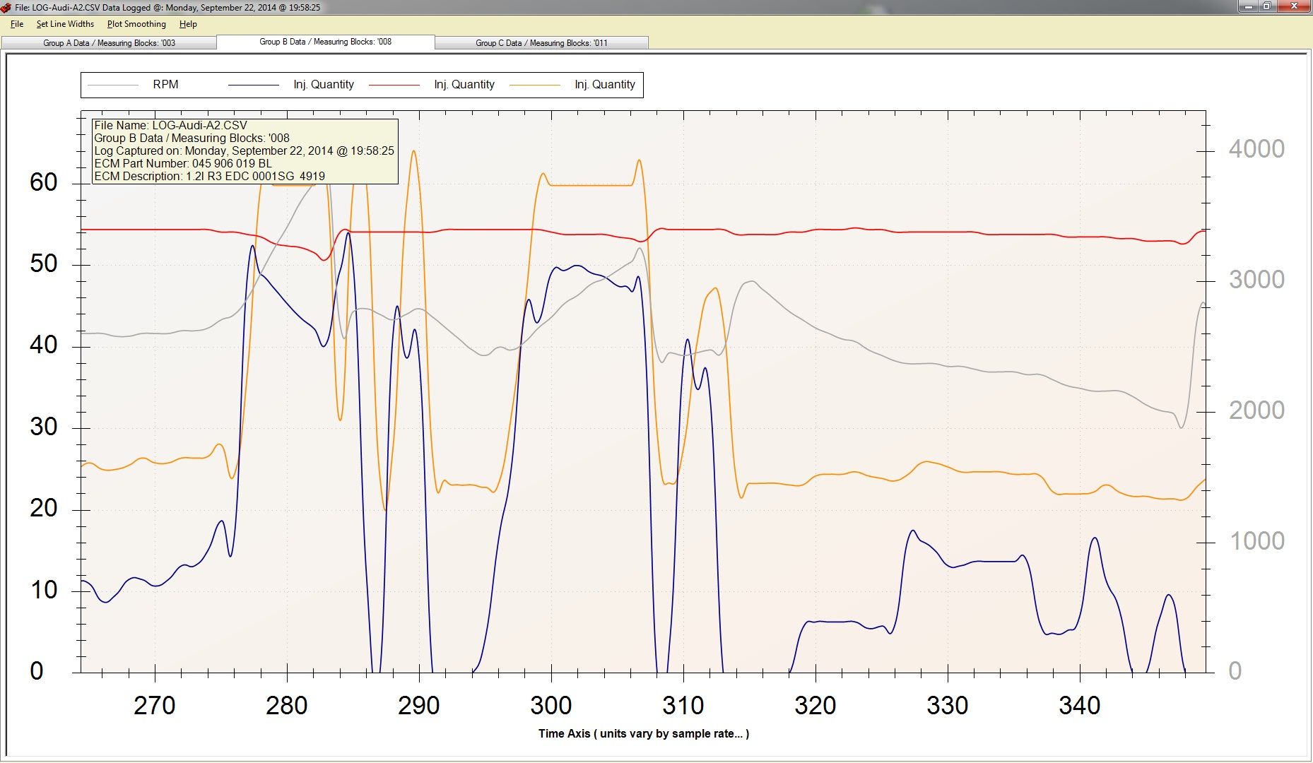

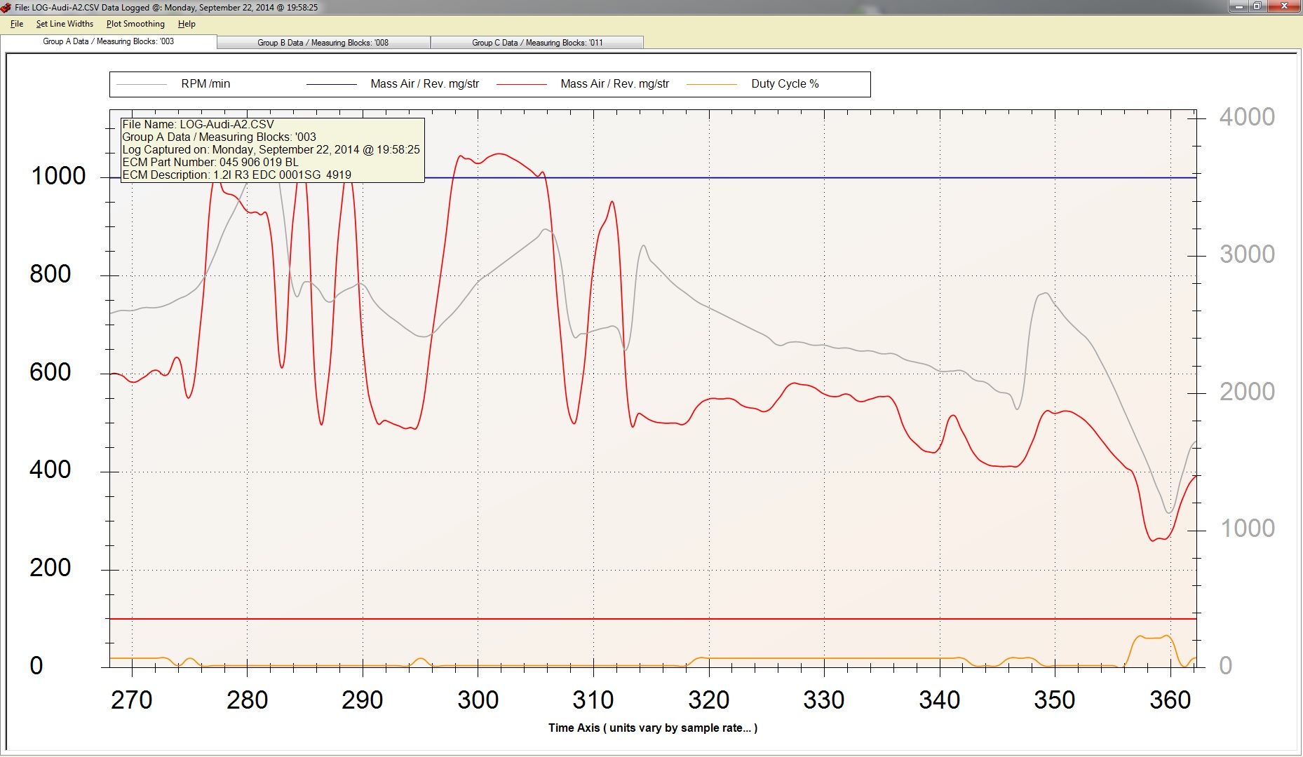

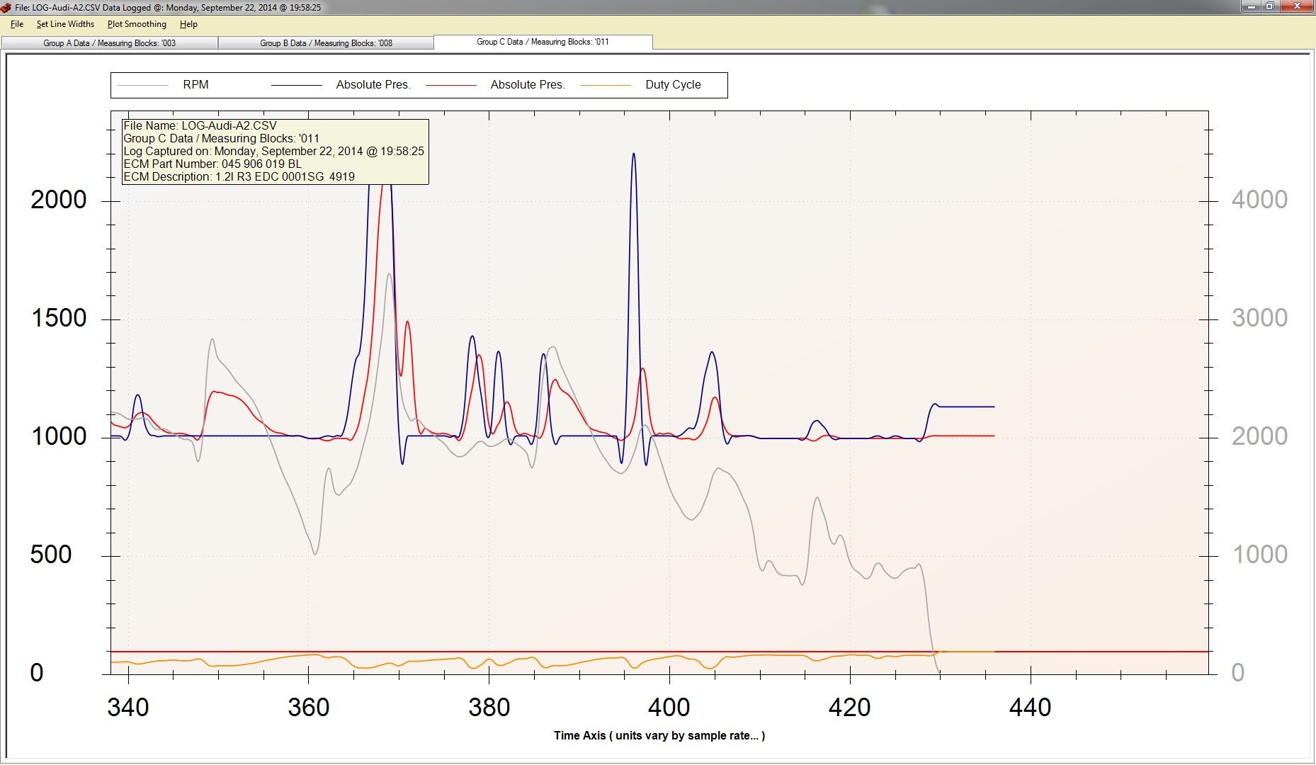

Gerrit Speek zegt het volgende: http://www.gerritspeek.nl/vag-com_dtc-17964.htmlVAG-COM Version: Release 409.1-S
Control Module Part Number: 045 906 019 BL
Component and/or Version: 1,2l R3 EDC 0001SG 4919
Software Coding: 00005
Work Shop Code: WSC 02154
Additional Info: WAUZZZ8Z64N010204 AUZ7Z0C2461257
1 Fault Found:
17964 - Charge Pressure Control: Negative Deviation
P1556 - 35-10 - - - Intermittent
